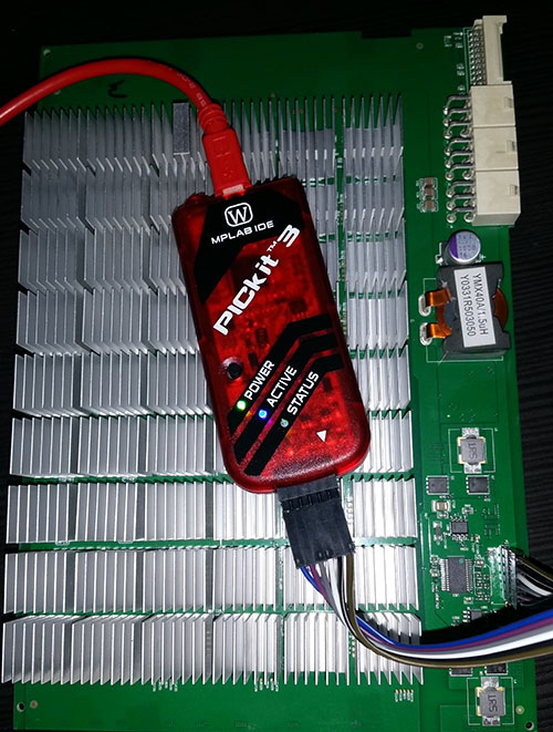

1. Use the programmer to connect the T9+ hash board; pin 1 of the programming cableis in front of the PICKIT arrow;

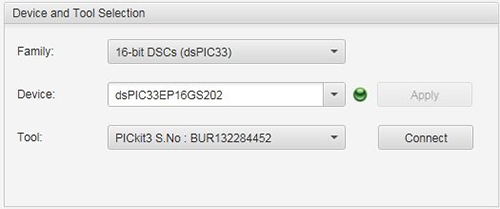

2. Connect MPLAB software;

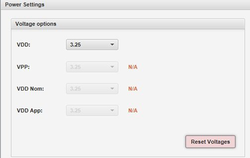

3. Enter advanced mode and get "Power Target Circuit" from the tool;

Programmer to target power is enabled - VDD = 3,250000 volts.
Target device dsPIC33EP16GS202 found.
Device ID Revision = 4003
